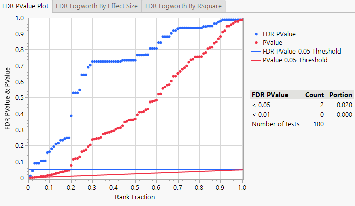

Response Screening automates the process of conducting tests across a large number of responses. The test results and summary statistics are presented directly in the report, or in data tables to enable further data exploration. Testing many responses for the effects of factors can be challenging, if not misleading, without appropriate methodology. A False-Discovery Rate approach guards against incorrect declarations of significance. Plots of p-values are scaled using the logworth, making them easily interpretable.

Figure 25.1 Example of a Response Screening PlotĀ
