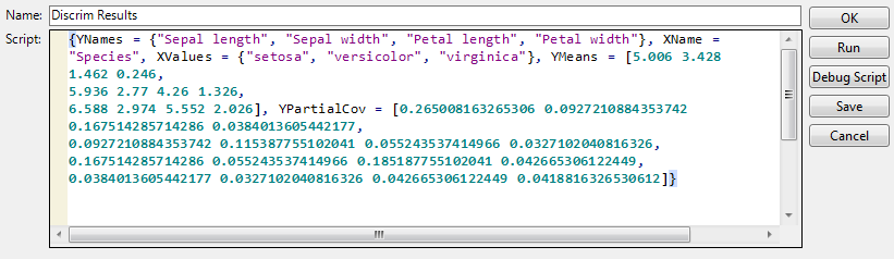

Consider the analysis obtained using the Discriminant script in the Iris.jmp sample data table. If you select Save Discrim Matrices from the Discriminant Analysis red triangle menu, the script Discrim Results is saved to the data table.
Figure 5.13 Discrim Results Table Script for Iris.jmp
Note: In a script, you can send the scripting command Get Discrim Matrices to the Discriminant platform object. This obtains the same values as Save Discrim Matrices, but does not store them in the data table.
