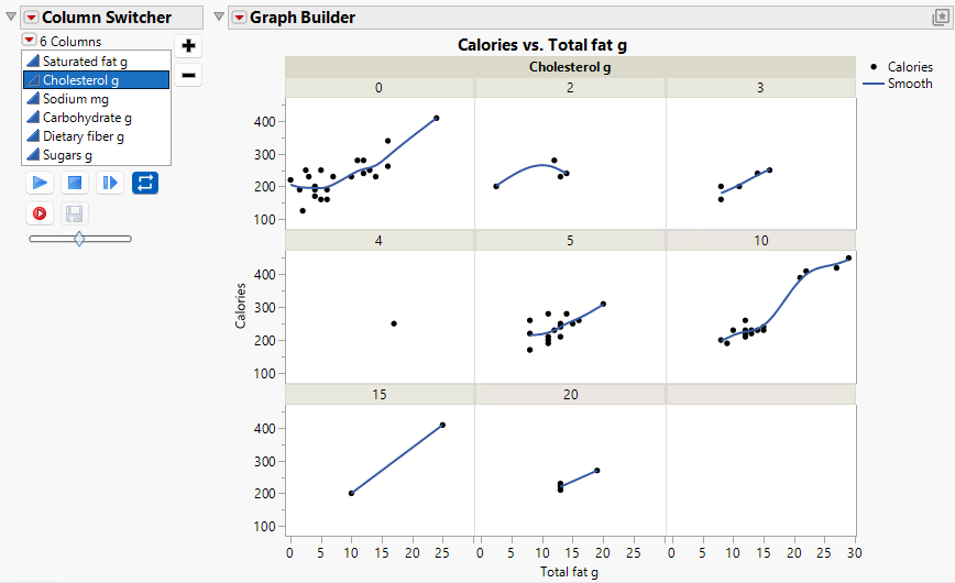

Column Switcher
Within a report, use the Column Switcher to quickly analyze different variables without having to re-create your analysis. To activate the Column Switcher, from a report window, click the red triangle and select Redo > Column Switcher.
If you have multiple columns, use the buttons to animate the column switching or step through each column manually. Move the slider control to change the speed of the animation.
Note: You cannot copy or move the column switcher within a report. Also, a column switcher cannot be saved to a JMP journal.
Example of the Column Switcher
You have data about nutrition information for candy bars. You want to examine different factors to see which factors best predict calorie levels.
1. Select Help > Sample Data Folder and open Candy Bars.jmp.
3. Click Total fat g and drag to the X zone.
4. Click Calories and drag to the Y zone.
5. Click Cholesterol g and drag to the Wrap zone.
6. Click the Graph Builder red triangle and select Show Control Panel.
7. Click the Graph Builder red triangle and select Redo > Column Switcher.
8. Select Cholesterol g.
This chooses the initial column to switch.
9. Select Saturated fat g, Cholesterol g, Sodium mg, Carbohydrate g, Dietary fiber g, and Sugars g.
This chooses the replacement columns.
10. Click OK.
Figure 9.6 Column Switcher in Graph Builder Window
11. Click the Play button to cycle between the different factors.
Use the slider to control the speed of the animation. Alternatively, you can step through each factor individually.
Click the Looping button to specify the behavior of the animation when it reaches the last column in the Columns list.
You can see that the relationship between calories and fat is relatively strong for each level of carbohydrate. Therefore, Carbohydrate g appears to be the best predictor of calorie levels.
