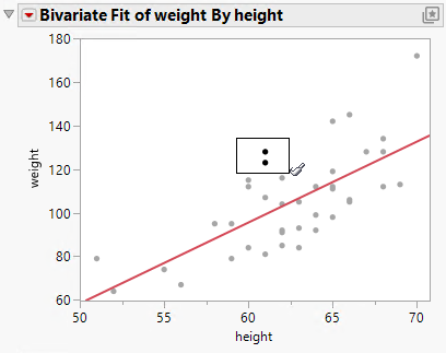

Figure 9.31 Using the Brush Tool
4. Release the mouse. The points within the rectangle and the data table remain selected.
