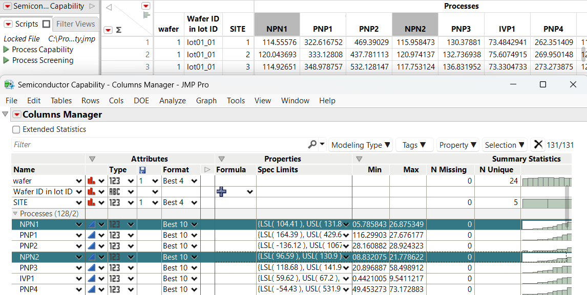

The Columns Manager option in the Cols menu helps you quickly select columns by attributes, properties, and statistics, particularly in a data table that has many columns. You can view summary statistics and properties for those columns, view quartiles in the summary statistics, subset the data, and more. Columns in the Columns Manager window are also linked to columns in the data table.
Figure 4.11 Linked Columns in the Column Manager

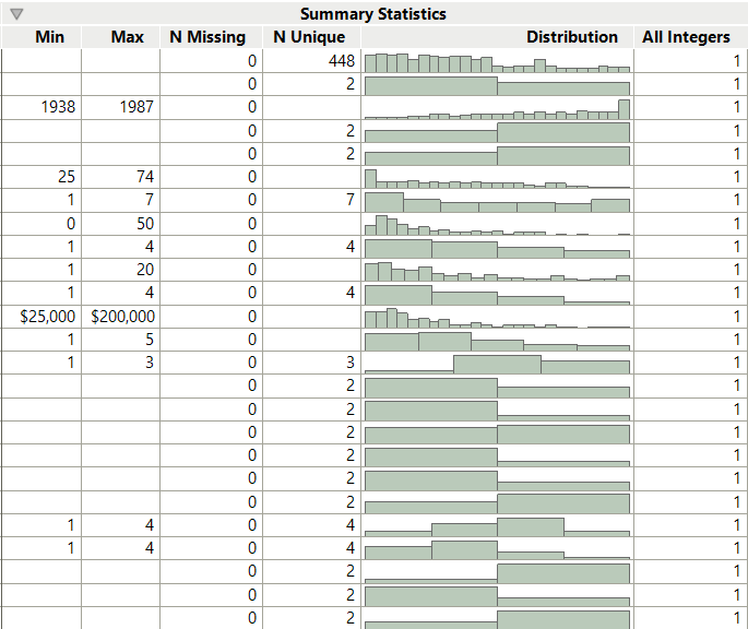

The Columns Manager gives you a quick view of data table characteristics. For example, the Summary Statistics shows which columns contain missing values. You can select those columns in the report and then exclude them in the data table.
Figure 4.12 Identify Missing Values
The Summary Statistics shows the following information:
The total number of rows (N)
The number of rows with missing values (N Missing)
The number of unique values (N Unique)
The Min and Max, a Distribution, and the number of Integers for continuous data

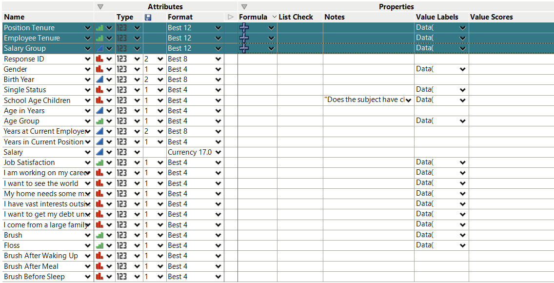

3. Select the Formula column twice to sort by Ascending.
Columns that have a Formula property appear at the top of the Columns Manager.
Figure 4.13 Sort the Formula Columns in the Columns Manager

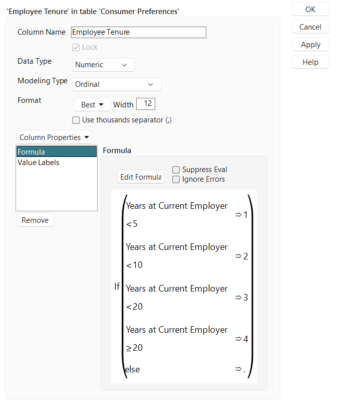

4. Select the Employee Tenure, Position Tenure, and Salary Group columns and select Cols > Column Info.
Formulas for the selected columns appear in the data table’s Column Settings window.
Figure 4.14 View Formulas in the Column Settings Window

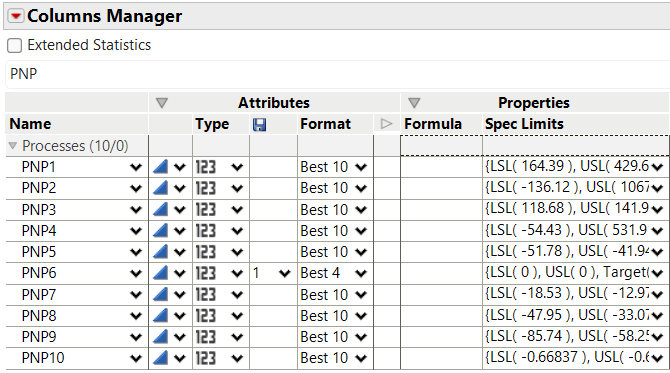

3. Type PNP in the Filter box and press Enter.
4. Expand the processes group to show the PNP columns.
The grouped processes are shown.
Figure 4.15 Filter Columns by Name

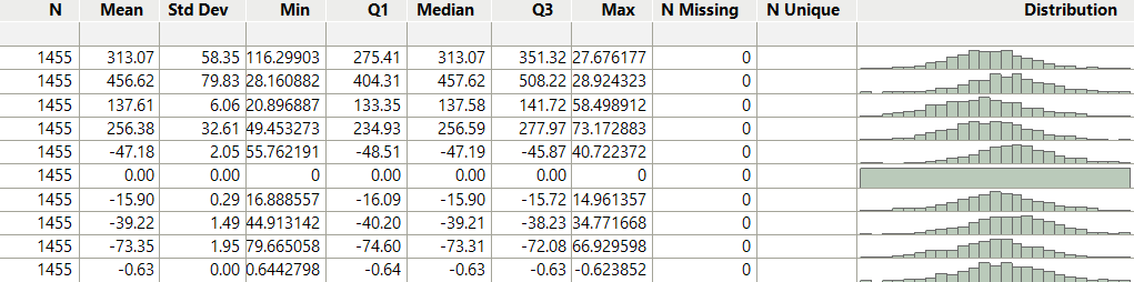

5. Click Extended Statistics to add additional summary statistics to the Columns Manager window.
The rows show the number, mean, standard deviation, minimum, first quartile, median, third quartile, maximum, number of missing values, number of unique values, and the distribution for each column.
Figure 4.16 Extended Summary Statistics for Selected Columns

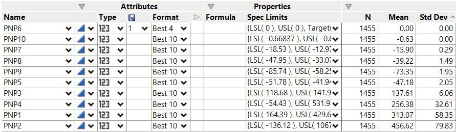

6. Select the Std Dev column twice to sort by Ascending.
Notice that PNP6 has no standard deviation because the minimum, maximum, and mean values are 0.
