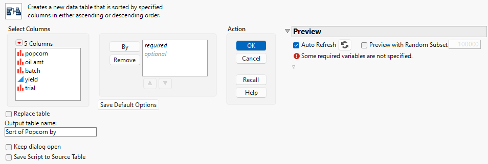

2. Select Tables > Sort.
Figure 6.5 The Sort Window
The Sort Window

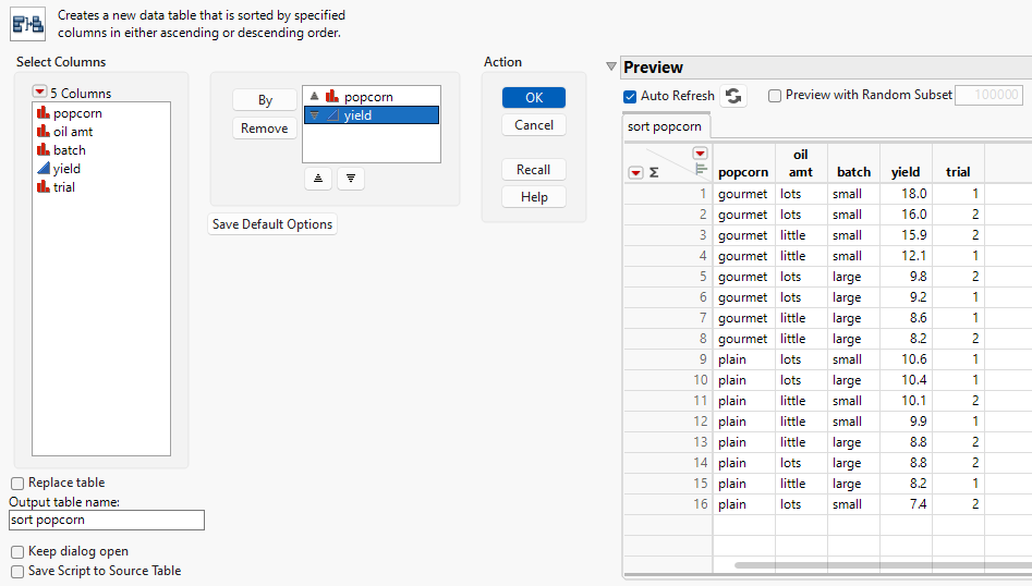

3. Highlight the names of the columns that you want to sort by.
For this example, select popcorn and yield.
4. Click By to add the columns to the sort list.
The columns that you add to the list establish the order of precedence for sorting. The first column in the list is the major sort field. Each variable thereafter is sorted within the previous variable in the sort list. You can drag and drop within the By list to change the sort order.
5. Customize your sort further by using the additional options.
For this example, highlight yield and click the descending button Image shown here.
6. Enter a name for the new sorted table in the box beside Output table name.
For this example, enter sort popcorn.
Figure 6.6 Completed Sort Window
7. Click OK.
