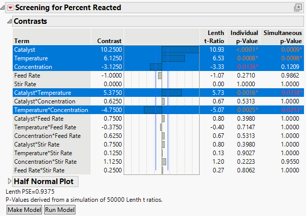

The following example sets the number of simulations to 50,000.
1. Select Help > Sample Data Folder and open Reactor Half Fraction.jmp.
2. Select DOE > Classical > Factor Screening > Fit Two Level Screening.
3. Select Percent Reacted and click Y.
4. Select Feed Rate through Concentration, click X, and then click OK.
5. Click the red triangle next to Screening for Percent Reacted and select Save Script > To Script Window.
6. Insert LenthSimN=50000; as the first line of the script.
LenthSimN=50000;
Fit Two Level Screening(
	Y( :Percent Reacted),
	X( :Feed Rate, :Catalyst, :Stir Rate, :Temperature, :Concentration )
7. Right-click in the script window and select Run Script.
Figure 11.10 Fit Two Level with N = 50,000 Simulations for p-Value Derivations
The number of simulations is stated in the report window. Since the p-values are obtained using a simulation-based technique, your p-values might not precisely match those shown here.
