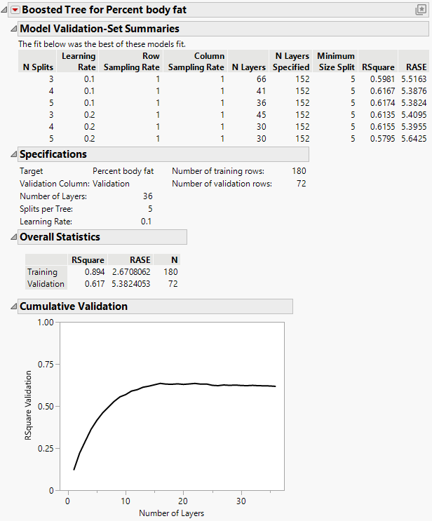

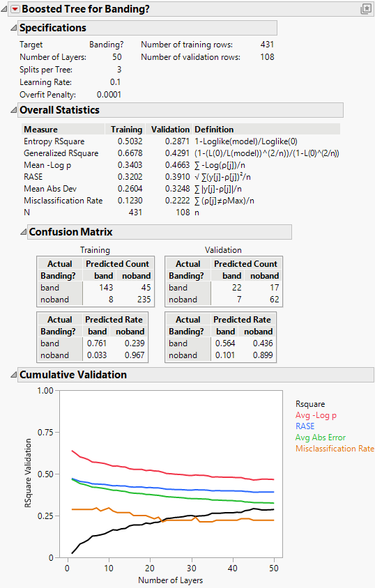

After you click OK in the Gradient-Boosted Trees Specification window, the Boosted Tree report opens.
Figure 6.8 Boosted Tree Report for a Continuous Response
Figure 6.9 Boosted Tree Report for a Categorical Response
The following reports are provided, depending on whether the response is categorical or continuous:
Model Validation Set Summaries
Specifications
Overall Statistics
Cumulative Validation
