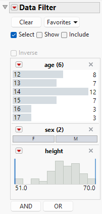

After you add columns in the initial window, the Data Filter panel appears.
Figure 9.8 Data Filter Panel
Data Filter Panel
The main controls in the Data Filter panel include the following options:
Clear
Clears all selections that you made on variables in the Data Filter panel.
Favorites
Saves your current Data Filter criteria as a favorite. After you create a favorite, selecting it resets the current conditions to the criteria in the favorite. You can also remove the favorite. To retain favorites after the current session ends, save the Data Filter script by selecting one of the Save Script options from the Data Filter red triangle.
Select, Show, and Include
See Filtering Modes.
Inverse
Inverts the current selection state of the rows in the data table.
Note: Only the rows in the data table are inverted, not the selection in the Data Filter. To invert the selection in the Data Filter, from the column’s red triangle, select Invert Selection.
AND
The AND button opens the Add to Selected Group list. The AND operator restricts the selection. You can add variables to the filter process at any time.
OR
The OR button opens the Add new OR Group list. The OR operator extends the selection. You can add variables to the filter process at any time.

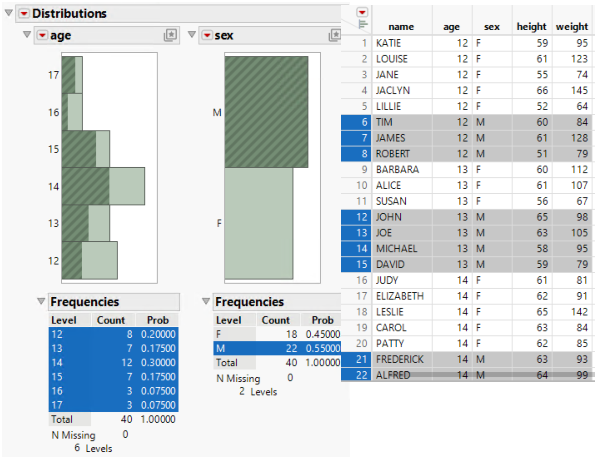

Example of Changing Selections
1. Select Help > Sample Data Folder and open Big Class.jmp.
2. Select Analyze > Distribution.
3. Select age and sex and click Y, Columns.
4. Click OK.
5. Select Rows > Data Filter.
6. Select sex and click Add.
7. In the Data Filter control panel, select all of the males by clicking the M block.
Figure 9.9 Rows That Contain Males Highlighted in Data Table and Histograms
You see that all of the rows that contain males are highlighted in the data table and in the histograms. Now you decide that you want to see only the students who are age 12.
