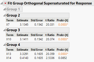

The Fit Group Orthogonal Supersaturated Report has two sections. The first section reports the estimates of active effects within each group, fitting one group at a time. Only active groups are shown. This is Stage 1 of the analysis. In Stage 2 a combined model is constructed
Figure 27.5 Stage 1 FindingsĀ
Stage 1 Findings
Term
Main effects that are identified as active.
Estimate
Parameter estimate for a regression fit of Y on the main effect.
Std Error
The standard error of the estimate, computed using the fake factors in Group 1.
t Ratio
The Estimate divided by its Std Error.
Prob>|t|
The p-value computed using the t Ratio and the degrees of freedom for error (DF).
