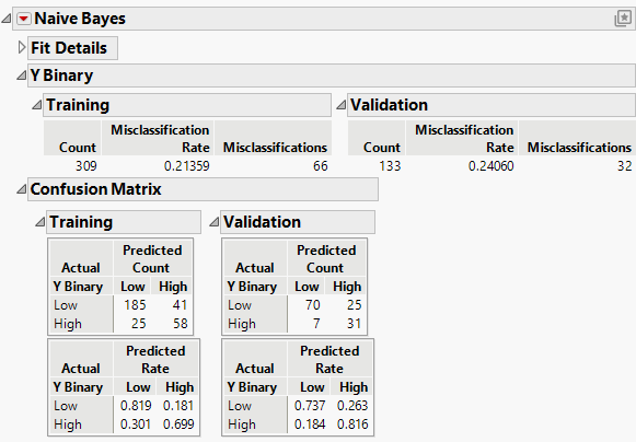

Image shown hereThe Naive Bayes Report
By default, the Naive Bayes report contains reports for fit details, the response column, the Confusion Matrix report, and the ROC and Lift curves.
Figure 8.7 Naive Bayes Report
Naive Bayes Report

Image shown hereConfusion Matrix Report
The Confusion Matrix report in the Naive Bayes platform shows a confusion matrix and a confusion rates matrix for the Training set, and for the Validation and Test sets if they are specified. A confusion matrix is a two-way classification of actual and predicted responses. A confusion rates matrix is equal to the confusion matrix, with the numbers divided by the row totals.
