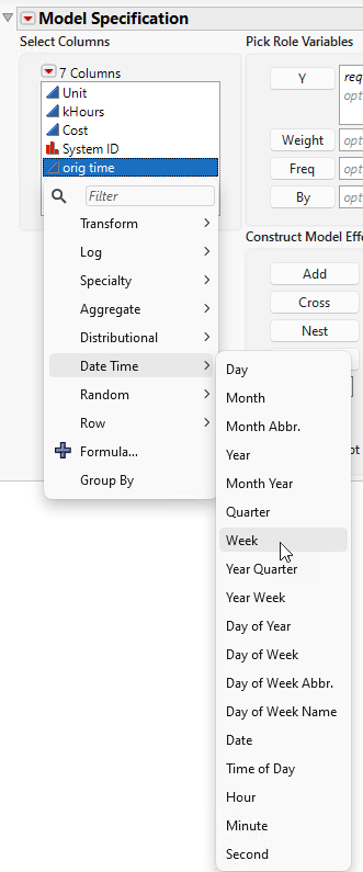

Each launch window in JMP enables you to create one or more temporary transform columns for use in performing analyses. These transform columns are not part of the source data table and can be used only within the context of the current launch window. Transform columns use formulas or calculations to define the column values. Closing the launch window deletes any transform columns.
Each column listed in the Select Columns pane of the launch window includes an icon that represents the column’s modeling type (continuous, ordinal, or nominal) and the column name. Right-click a column name to create a transform column by using Transform, Character, Combine, Pairwise, Aggregate, Distributional, Date Time, Random, Row, Vector, or Formula to calculate the column’s values.
Right-click options depend on the selected column’s data type and number of columns that are selected.
Figure 4.44 Example of Transform Column Menu

Date Time Menu
For column values that contain date or time values, select a function from the Date Time menu to create a transform column that contains values that are calculated from the selected column.
The following functions are included in the menu:
