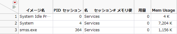

また、cmd.exeを使用せずにプロセス一覧を直接出力させ、データテーブルに読み込むこともできます。
blob = Run Program( Executable( "tasklist.exe" ), Read Function( "blob" ));
Open(blob,
Columns(
Column( "Image Name", Character, "Nominal" ),
Column( "PID",Numeric,
"Continuous",Format( "最適", 10 )
Column( "Session Name", Character, "Nominal" ),
Column( "Session#",Numeric,
Column( "Mem Usage", Character, "Nominal" ),
Omitted Column( . )),
Import Settings(
Fixed Column Widths( 26, 9, 17, 12, 12, 63 ),
Labels( 1 ), Column Names Start( 2 ), Data Starts( 4 ))
図8.4 Imported Data from Run Program()
