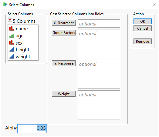

dlg = Column Dialog(
	Col ID = Col List( "X, Treatment", Max Col( 1 ) ),
	Group = Col List( "Group Factors" ),
	Split = Col List( "Y, Response" ),
	w = Col List( "Weight" ),
	H List( "Alpha", alpha = Edit Number( .05 ) )
Figure 11.36 Column Dialog
Column Dialog
The following example returns a list similar to this one, depending on the user’s choices:
{Col ID = {}, Group = {}, Split = {}, w = {}, alpha = 0.05, Button( -1 )}

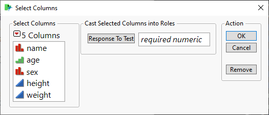

The following example generates a column dialog box that allows the selection of exactly one numeric column:
rt_dlg = Column Dialog(
	cv = Col List( "Response To Test", MaxCol( 1 ), MinCol( 1 ), DataType( "Numeric" ) )
Figure 11.37 Restricting Selection of Columns
The Data Type choices are Numeric, Character, and Any.
