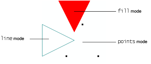

Fill Pattern
Polygons are rendered with both a front and a back, and the drawing mode of each side is customizable. This enables the user to see the difference between the back and front of the polygon.
To set the drawing mode of a polygon, use the Polygon Mode function.
Polygon Mode( face, mode )
where face can be FRONT, BACK, or FRONT_AND_BACK, and mode can be POINT, LINE, or FILL.
Figure 13.12 Points, Line, and Fill Modes
For example, the following script creates a display list that defines a triangle. This display list is used three times in conjunction with Translate, Rotate, and Color commands to draw triangles in three positions. In addition, the Polygon Mode command changes the drawing mode of each triangle. Note there is no explicit call to the FILL mode, since it is the default.

scene << Rotate ( 90, 0, 0, 1 );
scene << Translate ( -0.5, 0, 0 );
scene << Color( 0, 0.5, 0.5 );
scene << Polygon Mode( FRONT_AND_BACK, LINE );
scene << Call List( shape );
// update the scene to see the triangle
scene << Update;
Draw the second triangle in teal. Note that we first rotate the triangle.
Image shown here
And then translate it.
Image shown here
scene << Rotate( 90, 0, 0, 1 );
scene << Translate( -0.5, -1, 0 );
scene << Color( 0, 0, 0 );
// large points so that they are visible
scene << Point Size( 5 );
scene << Polygon Mode( FRONT_AND_BACK, POINT );
scene << Update;
Draw the third triangle as black points. First rotate.
Image shown here
And then translate to get the final picture.
Image shown here
