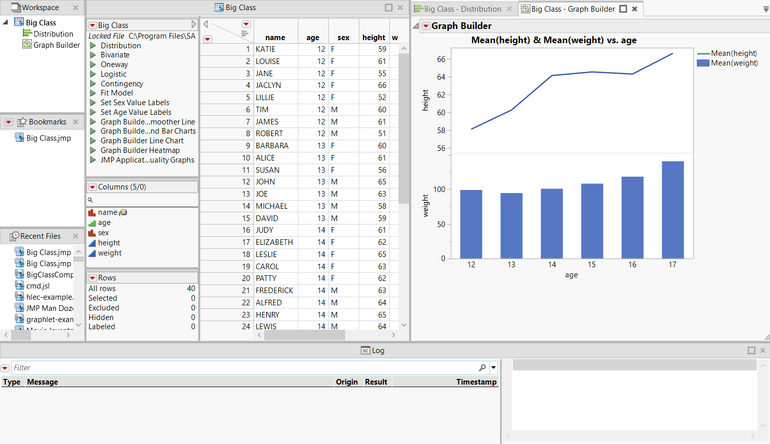

Figure 16.2 Example of a Complex Project
