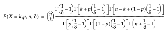

Beta Binomial Probability(k, p, n, delta)
Description
Returns the probability mass function (pmf) of the beta binomial distribution. This is the probability that a beta binomially distributed random variable is equal to k. The pmf is parameterized as follows:
Equation shown here
Arguments
k
The count of interest. k must be an integer.
p
The probability of success for each trial, which must be between 0 and 1.
n
The number of trials, which must be greater than 1.
delta
The overdispersion parameter δ, which must be between Maximum[-p/(n-p-1), -(1-p)/(n-2+p)] and 1. When the overdispersion parameter is zero, the distribution reduces to Binomial(n, p).
Notes
The beta binomial distribution results from assuming that X|π follows a Binomial(n,π) distribution and π follows a Beta(p(1-δ)/δ,(1-p)(1-δ)/δ) distribution. It is useful when the data are a combination of several Binomial distributions that each have different probabilities of success.
See Also
“Distributions” in Basic Analysis

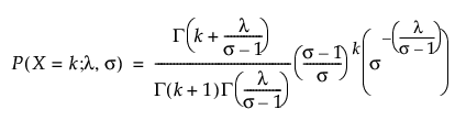

Gamma Poisson Probability(k, lambda, sigma)
Description
Returns the probability mass function (pmf) of the gamma-Poisson distribution. This is the probability that a gamma-Poisson distributed random variable is equal to k. The pmf is parameterized as follows:
Equation shown here
where Γ(·) is the Gamma function.
Arguments
k
lambda
The shape parameter λ, which much be greater than 0. This is the mean of the distribution.
sigma
The overdispersion parameter σ, which must be greater than or equal to 1. When the overdispersion parameter is 1, the distribution reduces to a Poisson(λ) distribution.
Notes
The gamma Poisson distribution results from assuming that X|μ follows a Poisson(μ) distribution and μ follows a Gamma(λ/(σ-1),σ-1) distribution. It is useful when the data are a combination of several Poisson(μ) distributions that each have different values of μ.
See Also
See “Distributions” in Basic Analysis

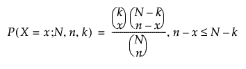

Hypergeometric Probability(N, k, n, x, <r>)
Description
Returns the probability mass function (pmf) of the hypergeometric distribution. This is the probability that a hypergeometrically distributed random variable is equal to x. The pmf is parameterized as follows:
Equation shown here
Required Arguments
N
The population size.
k
The number of items in the category of interest.
n
The sample size.
x
The count of interest, which must be less than or equal to n and k.
Optional Argument
r
The odds ratio.

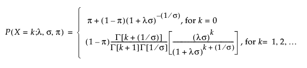

ZI Negative Binomial Probability(k, lambda, sigma, pi)
Description
Returns the probability mass function (pmf) of the zero-inflated negative binomial distribution. This is the probability that a negative binomially distributed random variable with location parameter lambda, scale parameter sigma, and zero-inflation parameter pi is equal to k. The pmf is parameterized as follows:
Equation shown here
Arguments
k
The number of successes before a specified number of failures.
lambda
The location parameter λ, which must be greater than 0.
sigma
The scale parameter σ, which must be greater than 0.
pi
The zero-inflation parameter, which must be greater than or equal to 0 and less than 1.

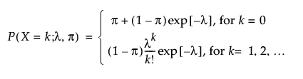

ZI Poisson Probability(k, lambda, pi)
Description
Returns the probability mass function (pmf) of the zero-inflated Poisson distribution. This is the probability that a Poisson distributed random variable with location parameter lambda and zero-inflation parameter pi is equal to k. The pmf is parameterized as follows:
Equation shown here
Arguments
k
The number of events in a given time interval. k must be an integer.
lambda
pi
