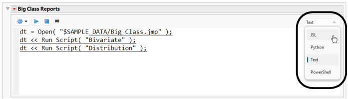

Change a Block’s Type
Select a block’s type using the menu in the upper-right of each block.
Changing a block’s type does not alter or remove any content of that block.
Figure 17.1 Change the Block type

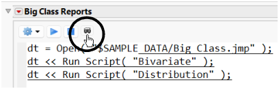

Collapsing Blocks and Sections
Click the mask icon to collapse a block so that only its heading is visible.
Figure 17.2 Collapse a Block
Collapse a Block

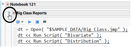

Sections can be collapsed by clicking the disclosure icon.
Figure 17.3 Collapse a Section
Collapse a Section

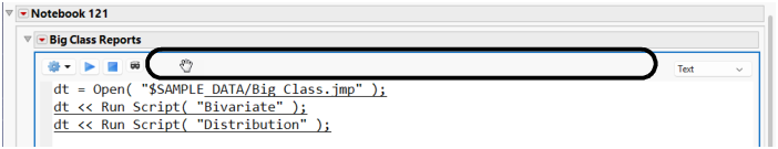

Reordering Blocks and Sections
Blocks can be dragged to a new position (even into other sections).
Drag from the block header. During the drag, shading appears to indicate where the drop will land.
Figure 17.4 Drag a Block from its Header
