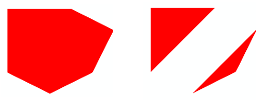

Experiment with the line
shape <<Begin(POLYGON);
by changing it to some of the other primitive types. For example, changing it to
shape <<Begin(TRIANGLES);
results in a different picture.
Figure 13.10 Polygon (left) and Triangles (right)
