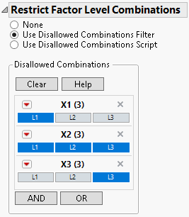

5. Select Use Disallowed Combinations Filter.
6. From the Add Filter Factors list, select all three factors and click Add.
7. Hold down the Ctrl key and select the following levels:
For X1, select L1.
For X2, select L1, L2, and L3.
For X3, select L3.
Figure 20.20 Completed Restrict Factor Level Combinations Panel

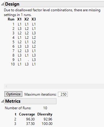

10. Click Make Design.
Figure 20.21 Design and Metrics Outlines
A note beneath the Design outline indicates that one run has a missing setting due to the constraints. That run is run 9. To ensure that the covering array has strength 2, the combination of X1 set to L1 and X3 set to L3 is required. But for these settings, the constraints prohibit all settings for X2.
