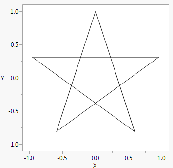

win = New Window( "Five-Point Star",
	Graph Box(
		Frame Size( 300, 300 ),
		X Scale( -1.1, 1.1 ),
		Y Scale( -1.1, 1.1 ),
		Line(
			{Cos( 1 * Pi() / 10 ), Sin( 1 * Pi() / 10 )},
			{Cos( 9 * Pi() / 10 ), Sin( 9 * Pi() / 10 )},
			{Cos( 17 * Pi() / 10 ), Sin( 17 * Pi() / 10 )},
			{Cos( 5 * Pi() / 10 ), Sin( 5 * Pi() / 10 )},
			{Cos( 13 * Pi() / 10 ), Sin( 13 * Pi() / 10 )},
Figure 12.10 Using Lines to Draw a StarĀ

The star example could also be drawn this way. Note that the script must include the full Matrix( {...} ) notation rather than [ ] shorthand because the entries are expressions. The following example uses the Matrix() function.
	Graph Box(
		Line(
			Matrix(
				{ // the x coordinates
				Cos( 1 * Pi() / 10 ), Cos( 9 * Pi() / 10 ), Cos( 17 * Pi() / 10 ),
				Cos( 5 * Pi() / 10 ), Cos( 13 * Pi() / 10 ), Cos( 1 * Pi() / 10 )}
			Matrix(
				{ // the y coordinates
				Sin( 1 * Pi() / 10 ), Sin( 9 * Pi() / 10 ), Sin( 17 * Pi() / 10 ),
				Sin( 5 * Pi() / 10 ), Sin( 13 * Pi() / 10 ), Sin( 1 * Pi() / 10 )}
