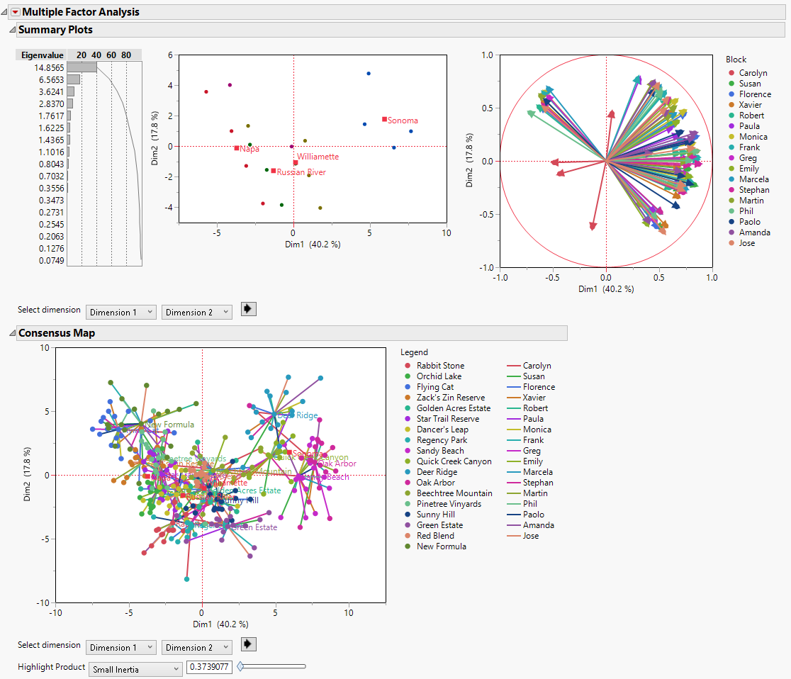

Figure 7.2 Initial Multiple Factor Analysis Report
Tip: To set the legend in the Consensus Map to two columns, double-click the legend and set the Item Wrap in the Legend Settings to 18.
Notice the following in the Summary Plots:
In the plot of the factor scores in the first two dimensions, the wines tend to cluster together according to their regions.
In the loading plot, the rays in the lower left quadrant correspond to Carolyn. They indicate a difference between Carolyn and the other raters.
7. In the legend next to the loading plot, click Carolyn to highlight her results.
Figure 7.3 Loading Plot with Results for Carolyn Highlighted
Carolyn’s results differ from the other panelists. You might want to re-run the analysis without her results. See Figure 7.6 for the results of the analysis without Carolyn.
