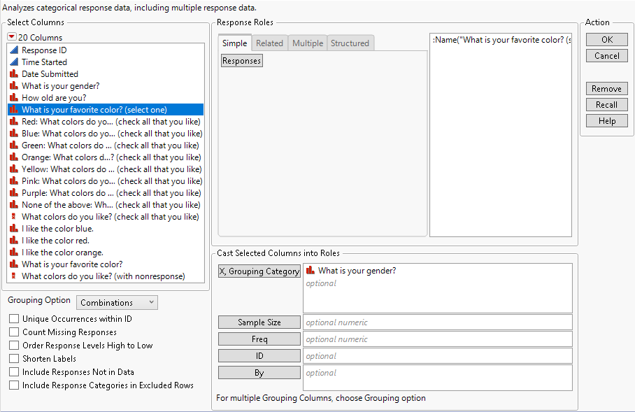

1. Select Help > Sample Data Library and open Color Preference Survey.jmp.
2. Select Analyze > Consumer Research > Categorical.
3. Select What is your favorite color? (select one) and click Responses.
4. Select What is your gender? and click X, Grouping Category.
Note: If you want to run the single analysis of favorite color by gender, click OK now.

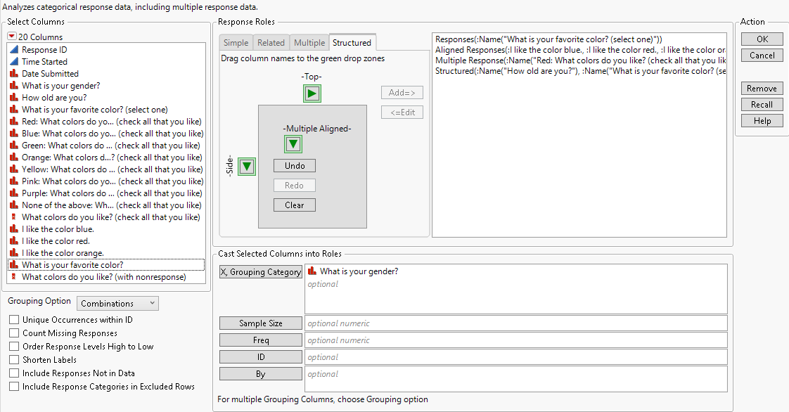

5. Select the Related tab.
6. Select I like the color blue. through I like the color orange. and click Aligned Responses.
This enters three questions with rating scales to be analyzed together. The gender grouping category applies to this analysis.
7. Select the Multiple tab.
8. Select Red: What colors do you like? (check all that you like) through None of the above: What colors do you like? (check all that you like) and click Multiple Response.
This enters the multiple response question “What colors do you like?” where each response is in an individual column for analysis. The gender grouping category applies to this analysis.

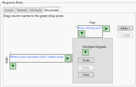

9. Select the Structured tab.
10. Drag What is your favorite color? (select one) to the Side green arrow and drag How old are you? to the Top green arrow.
Figure 3.3 Structured Tab in Categorical Launch Window
11. Click Add.
The What is your gender? column specified in the X. Grouping Category role does not apply to the structured analysis.
Tip: Click on the green arrows in the structured tab for a column list, where you can click to add a column.
Figure 3.4 Completed Launch Window for Full Example
12. Click OK.

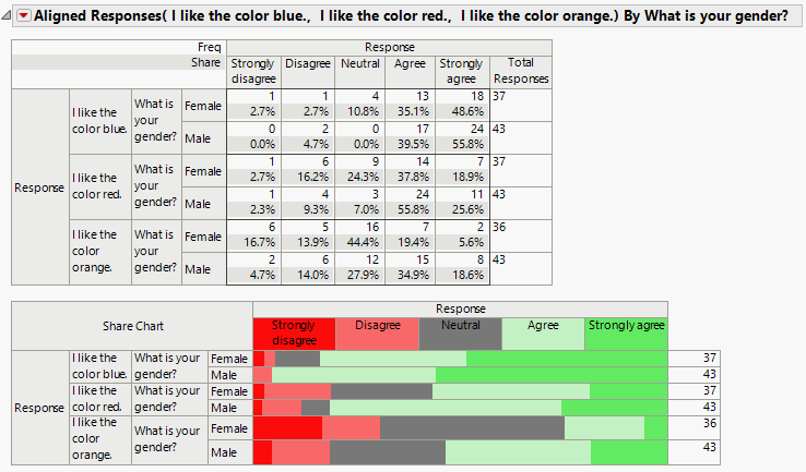

Related Tab Report
The second section of the report shows the results for three related questions that asked respondents to rank how much they liked a color. The responses to these questions are aligned, because the questions used the same rating scale of Strongly agree to Strongly disagree.
Figure 3.6 Aligned Response: Ranking Colors by Gender
The analysis shows that blue is the color with the highest rankings for both males and females. Orange has a high number of neutral results for both genders as compared to red and blue. The value colors column property is used to define the colors used in the share chart.
Note: If you analyze aligned questions individually using the Simple tab, you obtain three individual reports containing the same information as the related report. Using the Related tab aligns the reports so that the results are easier to compare to one another.
