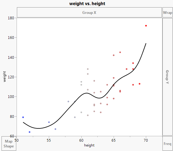

5. Select height and drag it to the Color zone.
Figure 4.36 Graph of height and weight Colored by height

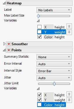

10. In the Heatmap options, click Variables. De-select X height and Y weight.
11. In the Points options, click Variables. De-select Color height.
Figure 4.38 Variables Options

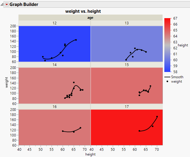

12. Double-click the X axis for height. In the X Axis Settings window, change the Minimum to 40, and click OK.
13. Double-click the Y axis for weight. In the Y Axis Settings window, change the Maximum to 200, and click OK.
13. (Optional) Click Done.
Figure 4.39 Scatterplots by Age with Background Color Showing Height
The panel colors are based on the average heights for students in each age group. As expected, the tallest students are the 17-year-olds. The plot in that panel shows how their weights vary by height.
