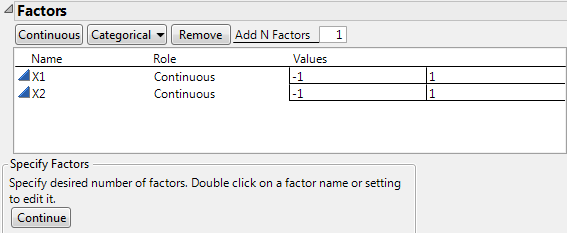

Add factors in the Factors outline.
Figure 21.4 Factors Outline
The Factors outline contains these options:

Tip: When you have completed your Factors panel, select Save Factors from the red triangle menu. This saves the factor names and values in a data table that you can later reload. See Space Filling Design Options.

Editing the Factors Outline
In the Factors outline, note the following:
To edit a factor name, double-click the factor name.
Categorical factors have a down arrow to the left of the factor name. Click the arrow to add a level.
To remove a factor level, click the value, click Delete, and click outside the text box.
To edit a value, click the value in the Values column.
