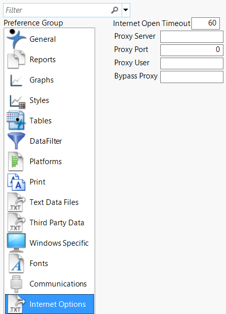

Internet Options specify settings for opening files from the Internet.
Figure 13.15 Internet Options
Table 13.15 Preferences on the Internet Options Page
Preference
Description
Internet Open Timeout
When you use Internet Open to open a web page, JMP waits the specified number of seconds before stopping the import due to an error. 60 seconds is the default value.
Proxy Server
Specifies the proxy host. http (or https) needs to be included with the specification. http is assumed if no protocol is used.
Proxy Port
Specifies the port used to connect to the proxy host. If none is specified, the port is 443 (for http) and 1080 for all others (https).
Proxy User
Specifies an optional user for the proxy. Not all proxy settings require a user.
Bypass Proxy
Specifies an optional comma-separated list of hosts to bypass (that is, not going through a proxy). A user might want to filter out hosts that are behind the corporate firewall (which don’t require a proxy).
