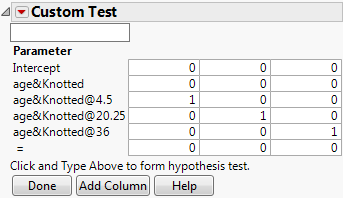

8. Click the Response ratio red triangle and select Estimates > Custom Test.
In the Custom Test report, notice that there is only one column. You want three columns.
9. Click the Add Column button twice to produce a total of three columns.
10. In the first column, type 1 for age&Knotted@4.5.
11. In the second column, type 1 for age&Knotted@20.5.
12. In the third column, type 1 for age&Knotted@36.
Figure 4.22 Values for the Custom Test for Curvature

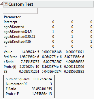

13. Click Done.
The small Prob > F value in the Custom Test report indicates that there is curvature.
Figure 4.23 Curvature Report
