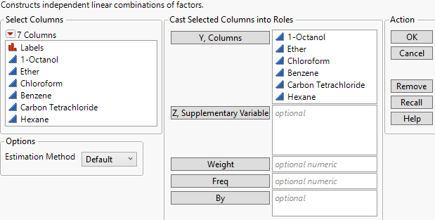

Launch the Principal Components platform by selecting Analyze > Multivariate Methods > Principal Components. Principal Component analysis is also available using the Multivariate and the Scatterplot 3D platforms.
The example described in Example of Principal Component Analysis uses all of the continuous variables from the Solubility.jmp sample data table.
Figure 4.3 Principal Components Launch Window
Y, Columns
The variables to analyze for components.
Z, Supplementary Variable
The supplementary variables to be displayed. Supplementary variables are not included in the calculation of principal components and including them does not affect the results. Supplementary variables that are continuous can be projected on to the loading plot and used to enhance interpretation.
Weight
Identifies one column whose numeric values assign a weight to each row in the analysis.
Note: The Weight role is ignored for the Wide and Sparse estimation methods.

By
Creates a Principal Component report for each value specified by the By column so that you can perform separate analyses for each group.
