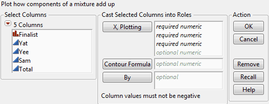

Launch Ternary Plot by selecting Graph > Ternary Plot.
Figure 11.5 The Ternary Plot Launch Window
X, Plotting
Assign three columns to generate a ternary plot.
If you assign more than 3 variables to the X, Plotting role, a matrix of ternary plots is created. A separate variable is assigned to the first two axes of a plot, with the third axis being the sum of the other variables. If necessary, the variables are scaled so they sum to 1.
