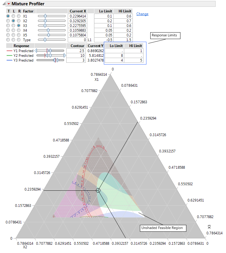

6. Enter 1 in the Y1 Predicted Hi Limit edit box. Enter 8 in the Y2 Predicted Lo Limit edit box. Enter 4 in theY3 Predicted Lo Limit edit box and 5 in the Y3 Predicted Hi Limit edit box.
7. The feasible region remains white (unshaded). Use the Response slider controls to position the contours in the feasible region. Alternatively, move the cross hair into the feasible region
Figure 6.12 Feasible Region After Setting Response Limits

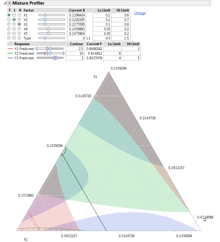

8. Select the magnifier tool to zoom in on the feasible region.
Figure 6.13 Ternary Plot with Enlarged Feasible Region

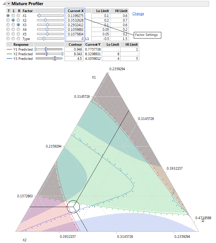

The manufacturer wants to maximize Y1, minimize Y2, and have Y3 at 4.5.
9. Use the slider controls or Contour edit boxes for Y1 Predicted to maximize the red contour within the feasible region. The Up Dots show direction of increasing predicted response.
10. Use the slider controls or Contour edit boxes for Y2 Predicted to minimize the green contour within the unshaded region.
11. Enter 4.5 in the Contour edit box for Y3 Predicted to set the blue contour to the target value.
The resulting three contours do not all intersect at one spot. Y1 and Y2 cannot be optimized with Y3 on target, so you have to compromise. Position the three-way crosshairs in the middle of the contours to explore the factor levels that produce those response values. Note that these response contours are for the current settings of x4, x5, and Type.
Figure 6.14 Factor Settings for Optimal Results
12. Click the Mixture Profiler red triangle and select Factor Settings > Remember Settings to save the current settings. The settings are appended to the bottom of the report window.
