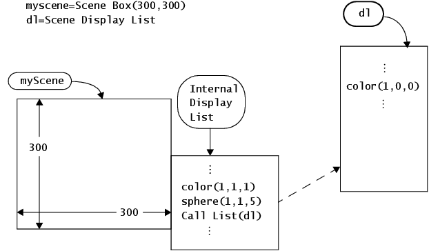

The scene can be sent messages that construct elements in the scene. Typical messages alter the viewer’s vantage point, construct physical elements in the scene itself, or manipulate lights and textures. These messages are maintained in a display list and are manipulated in one of two ways:
• They are sent as messages to the scene, which immediately adds them to the scene’s internal display list.
• They are sent as messages to a display list stored in a global variable, which is called by the scene’s display list later.
Figure 13.2 Constructing Scenes

Equivalently, the commands to construct the display can be accumulated in a display list stored in a global variable, which is then sent to the scene all at once. To define a global variable as a display list, assign it using the Scene Display List function. For example, to use the global greeting as a display list, issue the command
greeting=Scene Display List();
Display commands can then be sent as messages to greeting. An equivalent “Hello World” example using a display list follows.
