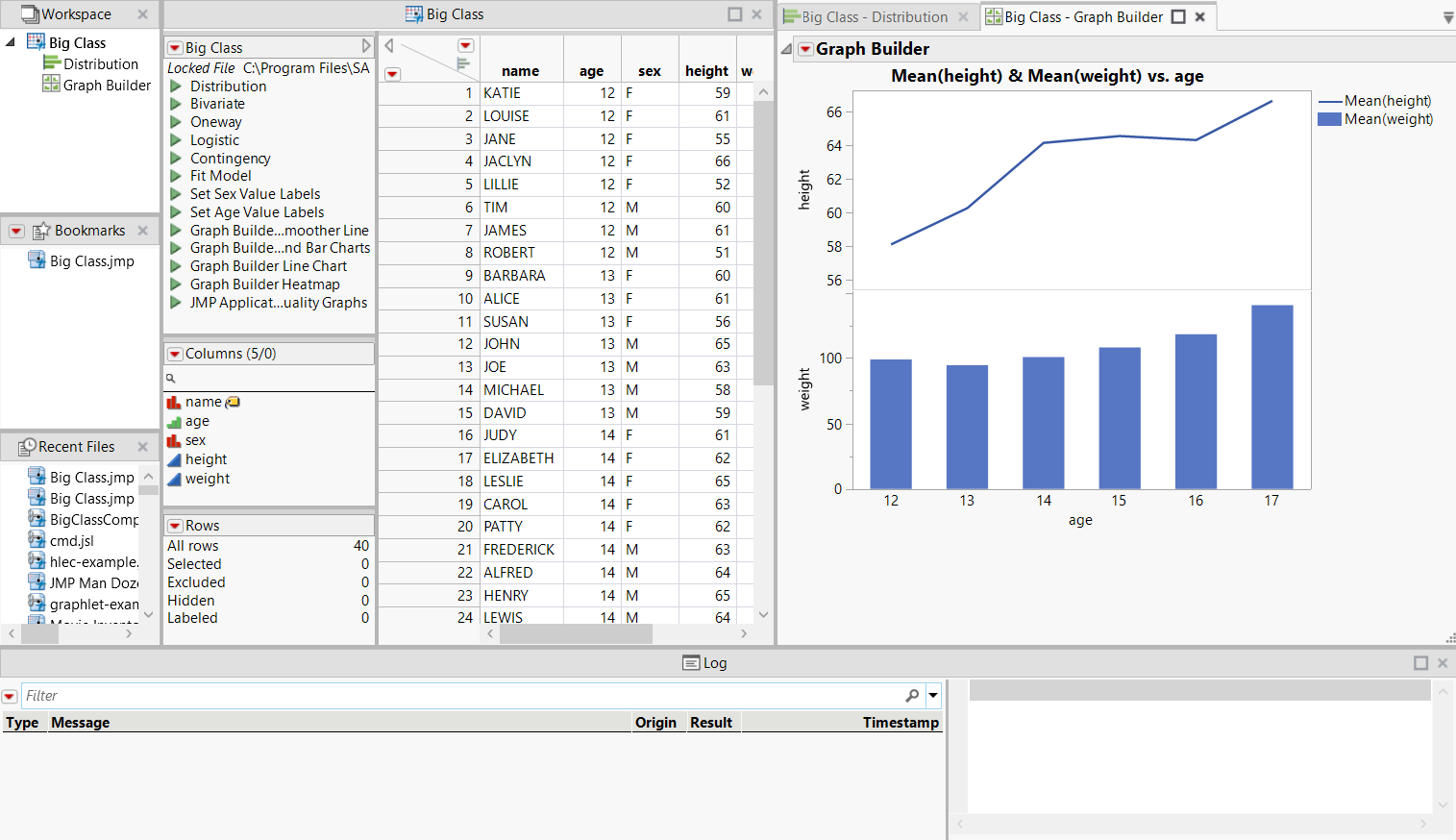

A more complicated JMP project might include a Bookmarks panel (to show file, folders, and groups that use frequently), and a project log. The data table and output are in separate tabs.
Begin by creating a new project and creating a bookmark.
project = New Project();
project << Add Bookmarks({
	File( "$SAMPLE_DATA/Big Class.jmp" )
Run Script opens the data table and creates output inside the project.

Set Layout specifies the layout of the tabs that show the data table and output.
project << Set Layout(
	V Splitter Box(
		Size( 1215, 700 ),
		<<Set Sizes( {0.77, 0.23} ),
		<<Dockable(),
		V Splitter Box(
			Size( 1215, 540 ),
			<<Set Sizes( {1} ),
			<<Dockable(),
			H Splitter Box(
				Size( 1215, 540 ),
				<<Set Sizes( {0.11, 0.42, 0.47} ),
				<<Dockable(),
				V Splitter Box(
					Size( 128, 540 ),
					<<Set Sizes( {0.33, 0.33, 0.33} ),
					<<Dockable(),
					Tab Page Box(
						Title( "Window List" ), // show the Window List
						Window ID( "Window List" )
					Tab Page Box(
						Title( "Bookmarks" ), // show the Bookmarks panel
						Window ID( "Bookmarks" )
					Tab Page Box(
			// show the Recent Files panel
						Title( "Recent Files" ),
						Window ID( "Recent Files" )
				Tab Page Box( // show the data table
					Title( "Big Class" ),
					Window ID( "data" )
				Tab Box(
					<<Dockable(),
					Tab Page Box( // show the Distribution graph and reports
						Title( "Big Class - Distribution" ),
						Window ID( "distrib" )
					Tab Page Box( // show the Graph Builder graph
						Title( "Big Class - Graph Builder" ),
						Window ID( "graphbuilder" )
		Tab Page Box( Title( "Log" ), Window ID( "Log" ) )

Figure 16.2 Example of a Complex Project
