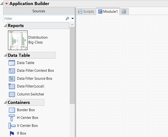

4. Click the Blank Application box.
A new blank application appears. Notice the Distribution report in the left column.
Figure 18.2 New Application with Distribution Report in the Sources Panel
5. In the Sources panel, drag the Distribution report onto the application workspace (the blank area on the Module1 tab).
6. Click the Application Builder red triangle and select Run Application.

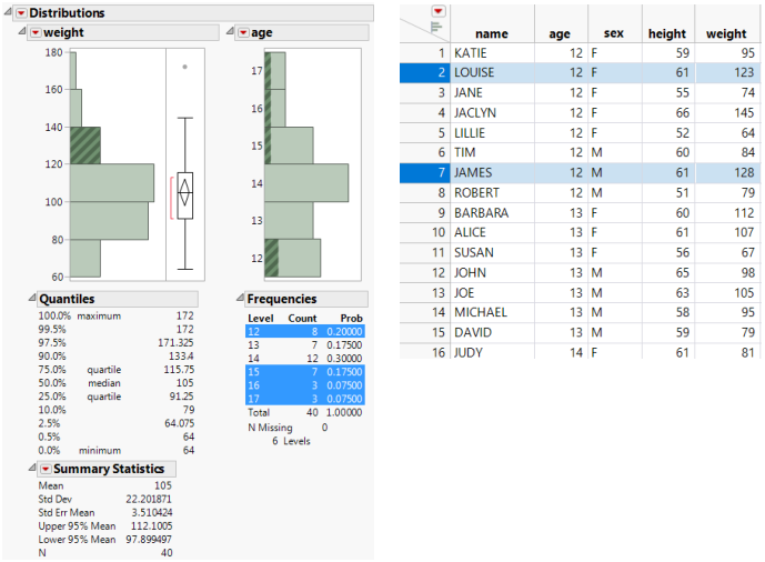

The Distribution report appears in a new window. Note that the histograms are interactive and still associated with the data table. When the data changes, you run the application again, and the Distribution report is updated.
