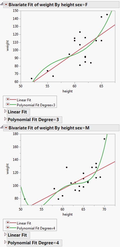

3. Click Run Script Image shown here.
The report window shows two graphs, one where sex is F and one where sex is M.

In the report window, a linear regression line is added to both graphs, with the corresponding Linear Fit reports.

In the report window, a polynomial fit line is added to the F graph, with the corresponding Polynomial Fit reports.

In the report window, a quartic fit line is added to the M graph, with the corresponding Polynomial Fit reports.
Figure 10.2 By Group Reports
By Group Reports
