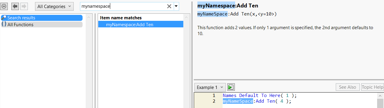

To define a custom function, use New Custom Function(). After a function is defined, you can add or activate it in the current running instance of JMP using Add Custom Functions() . Similarly, you can remove or deactivate a function using Remove Custom Functions().
New Custom Function() requires three parameters: namespace, functionName, functionDefinition. Additional messages may be passed to define the following:
funcDef = Function( {x, y = 10}, x + y );
description = "This function adds 2 values. If only 1 argument is specified, the 2nd argument defaults to 10.";
ex2 = Expr(
parmHint1 = "x value";
parmHint2 = "<y=10>";
newAdd << Description( description );
newAdd << Example( Name Expr( ex2 ) );
Add Custom Functions( newAdd );

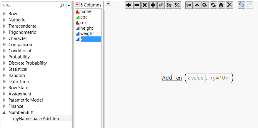

The Formula Category message results in a new category in the Formula Editor’s list of formula categories. Custom functions are shown with an underline in the Formula Editor. Also see the hint text from the Parameter messages.
