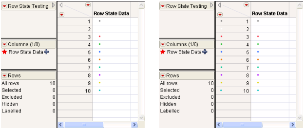

A row state column is a dedicated column that stores row state information, but does not put the information into effect. You can then use For Each Row to put the row state column into effect. For more information about row state columns, see “行状态列” in the Using JMP book.
For Each Row( Row State() = :Row State Data );
This action replaces any row states in effect with the row state combination from the row state column. For details about how to change selected attributes of a row state without changing or canceling others, see Set One Characteristic and Cancel Others.

Be careful whether you set every aspect of Row State() or just one aspect of it, such as Color Of( Row State() ). To see how this works, first color and mark all the rows:
For Each Row( rscol = Row State() );
To get a row state and store it in a global, place Row State() on the right side of an assignment. Add the following lines to the preceding script:
Show( x ); // returns x = Color State( 8 )
For Each Row( :rscol = Row State() );
