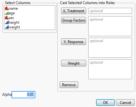

Column Dialog(), a variant of the deprecated Dialog() function, lets you prompt for column selections from the current data table or contextual data table. The OK, Cancel, and Remove buttons and the list of columns to choose from the data table are added automatically.
dlg = Column Dialog(
Group = Col List( "Group Factors" ),
Split = Col List( "Y, Response" ),
w = Col List( "Weight" ),
图 11.35 Column Dialog

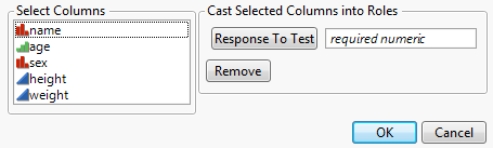

rt_dlg = Column Dialog(
图 11.36 Restricting Selection of Columns
