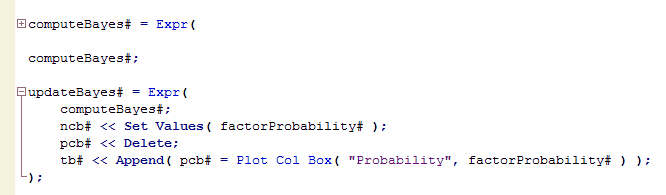

To turn on this feature, select JSL code folding in the Script Editor preferences. Then you can expand and collapse blocks of code by right-clicking on a script and selecting Advanced > Expand All or Collapse All.
提示:To fold or expand all code in the entire script, press SHIFT and CTRL then click on a code marker.
After you select this preference, Function and Expr expressions are foldable. See Add More Folding Keywords for details about adding folding markers to other expressions.
By default, code does not remain collapsed after you save the script and restart JMP. To save the state of the folded code, select Save and restore document state information in the Script Editor preferences.
