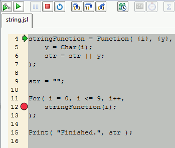

图 4.11 Set the Breakpoint
Click Run.
stringFunction is defined as a function.
str is defined as an empty string.

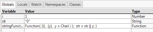

Both variables and their types and values have been added to the Globals list. In addition, the For() loop has been evaluated up to the line with the breakpoint, shown in 图 4.11.
i has been assigned to 0.
i and its value and type have been added to the Globals list.
i has been determined to be less than or equal to 9.
stringFunction() has not yet been called.

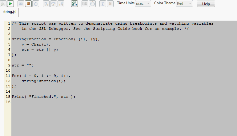

Open the string.jsl sample script.

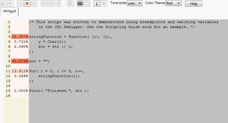

图 4.15 Initial JSL Profiler Window
图 4.16 Profiled Script Window
In the left margin, the selected statistics are displayed. Percent of time is displayed by default. Click the Show Profile by Count button
to switch to percent of statement counts instead. The left margin is color-coded to allow for quick identification of problematic performance areas.
to start profiling.
