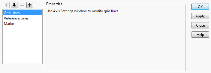

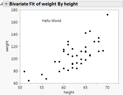

Right-click inside the graph and select Customize.
5.
提示:To use a script that references a column name, use Column( colname ) or a colon ( :colname ) to scope it properly.
Hint: To see the JSL for the above actions, select Save Script > To Script Window from the red triangle menu.
to add a new graphics script.
