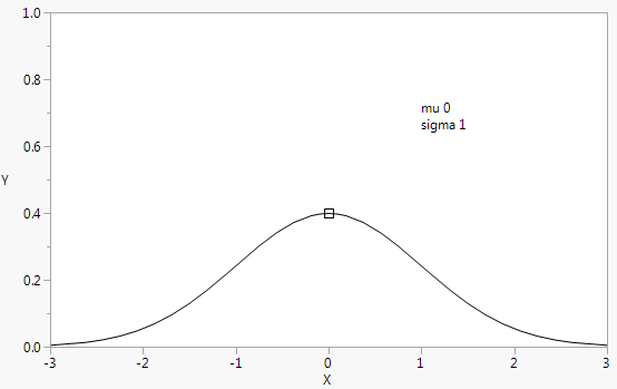

mu = 0;
sigma = 1;
Run demoPlotProb.jsl in the JMP Samples/Scripts folder to see Beta Density, Gamma Density, Weibull Density, and LogNormal Density graphs. The output for Normal Density is shown in 图 12.23. Because we cannot show you the picture in motion, be sure to run this script yourself.

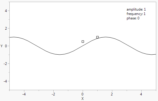

amplitude = 1;
freq = 1;
phase = 0;
图 12.26 Two Handles
