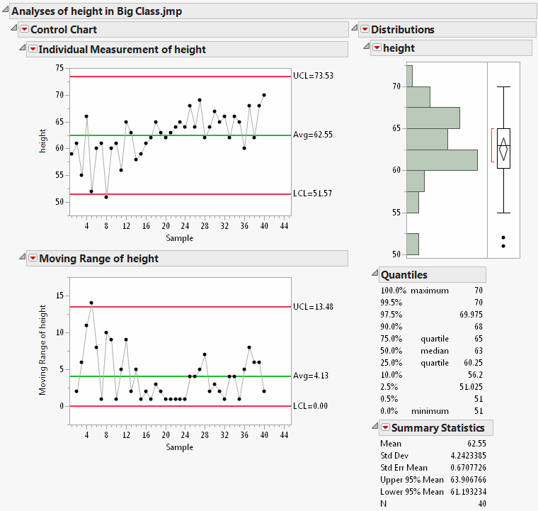

Another type of display that you might want to construct is your own combination of results from the analysis platforms in JMP. Write the platform script inside a display box and assemble the display boxes into a window. For ease in routing messages to it later, assign the whole script to a reference.
The following example creates several graphs and reports in one window:

Example: Multiple Graphs in One Report Window

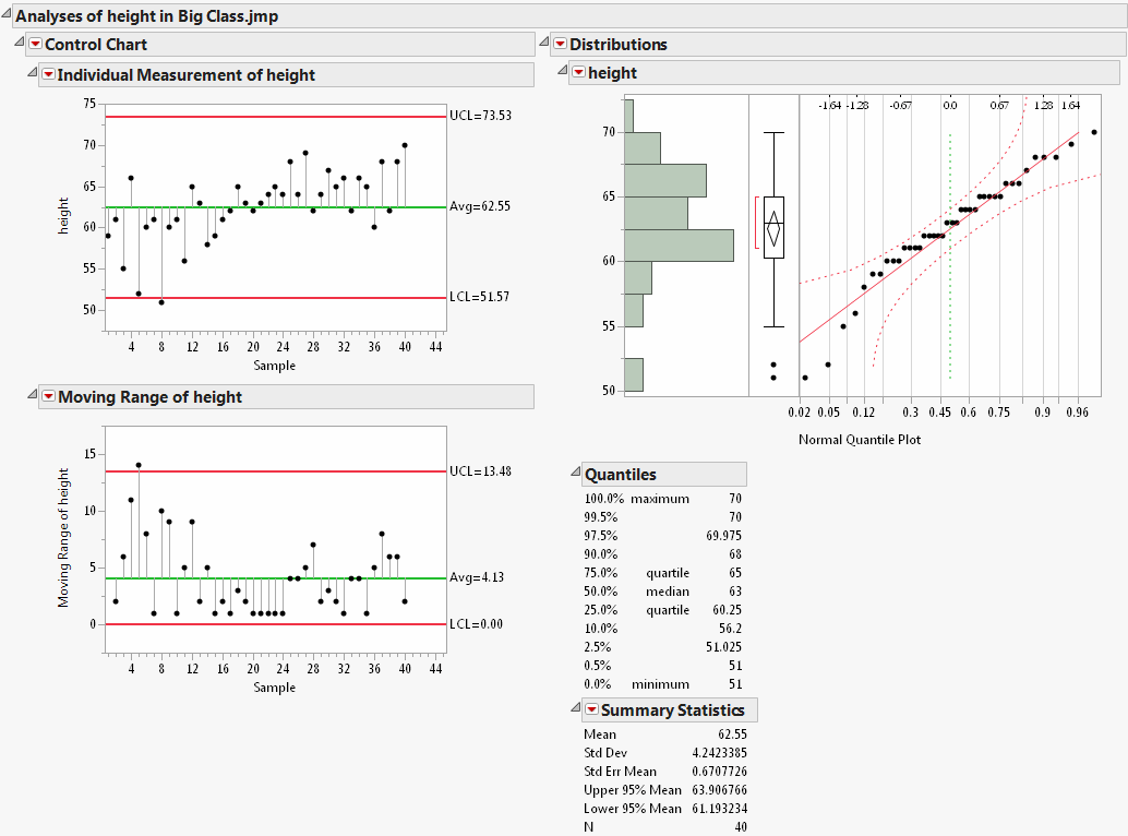

You can send messages directly to the platform references themselves. Find out your options by searching for “Distribution” and “Control Chart” in the JMP Scripting Index. For example, Control Chart provides a message called Needle that creates a needle chart. Distribution provides a message called Normal Quantile Plot.
To execute these options from JSL, send them as messages to the platform references:
cc << Needle;dist << Normal Quantile Plot;Changing a Custom Report
