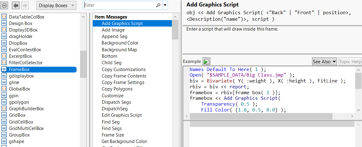

To find out which messages you can send to a frame box, select Help > Scripting Index and search for “frame box”.
Scripting Index Display Boxes List
Running the Show Properties() function is an alternative to using the Scripting Index. The messages for the specified display box are printed to the log.

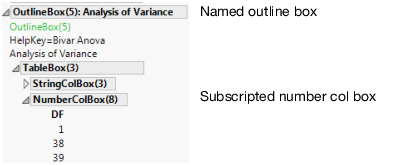

rp = dt << Bivariate(Y( :weight ),
X( :height ),
Fit Line( {Line Color( {213, 72, 87} )} ));
Print("C.Total DF=",
// string references the parent box
Report( rp )[Outline Box( "Analysis of Variance" )][
Number Col Box( 1 )][3] // subscript references the child box
Subscripted Display Box
The numbered subscripts (in the preceding example) are relative to the named box, which makes them less likely to change. However, this also means that the absolute numbers in Show Tree Structure can’t be used directly.
