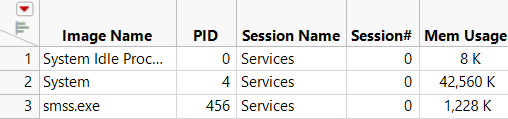

You can also print the task list directly without using cmd.exe and then import the task list into a data table.
blob = Run Program( Executable( "tasklist.exe" ), Read Function( "blob" ));
Open(blob,
Columns(
Column( "Image Name", Character, "Nominal" ),
Column( "PID",Numeric,
"Continuous",Format( "Best", 10 )
Column( "Session Name", Character, "Nominal" ),
Column( "Session#",Numeric,
Column( "Mem Usage", Character, "Nominal" ),
Omitted Column( . )),
Import Settings(
Fixed Column Widths( 26, 9, 17, 12, 12, 63 ),
Labels( 1 ), Column Names Start( 2 ), Data Starts( 4 ))
Imported Data from Run Program()
