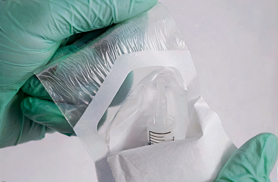

Engineers in a product development team for a manufacturer of medical equipment packaging are evaluating the performance of two different formulations of adhesive that's used to seal the packaging.
An important characteristic is that the adhesive is strong enough to withstand the usual sterilization and handling rigors while not so strong that it is difficult for a medical practitioner to open easily.
The engineers produce a sample of n=50 pouches sealed with each of these two new adhesive formulations (A and B). The peel strength on each specimen is measured using a device known as a universal testing machine.
The tester records the force (in Newtons) being applied across a range of peel displacement. The average force across a defined range of peel displacements is used as a single data value summarizing a test.
The specification for the adhesion is an average peel strength (m) of 11.0 N, along with +/- 3 standard deviations (3s) ≤ 1.5 N (i.e., s ≤0.5 N).
