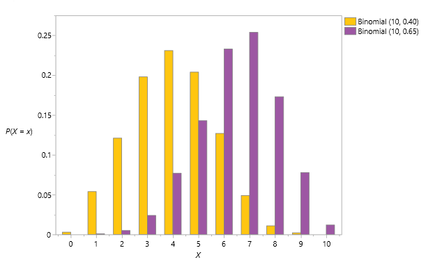

The graph below shows a binomial distribution when n = 10 for p = 0.40 and p = 0.65.
