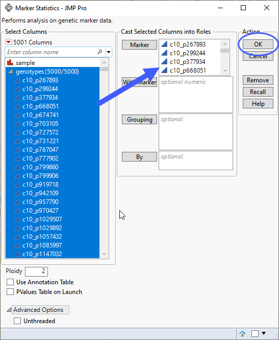

To make sure all markers have been numerically coded to the same allelic count basis, use the Marker Statistics platform (new in JMP Pro 17.0). This analysis consists of four steps:

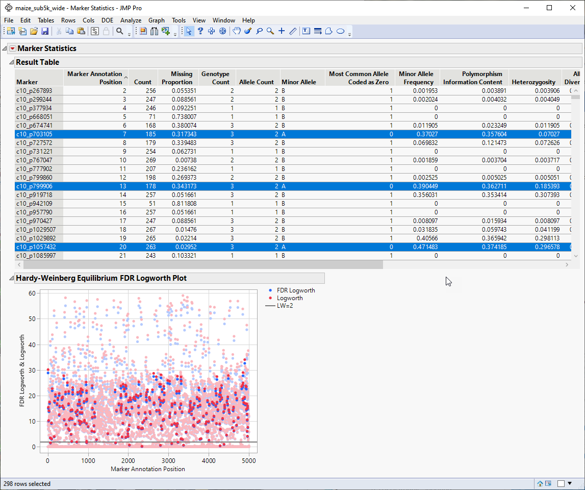

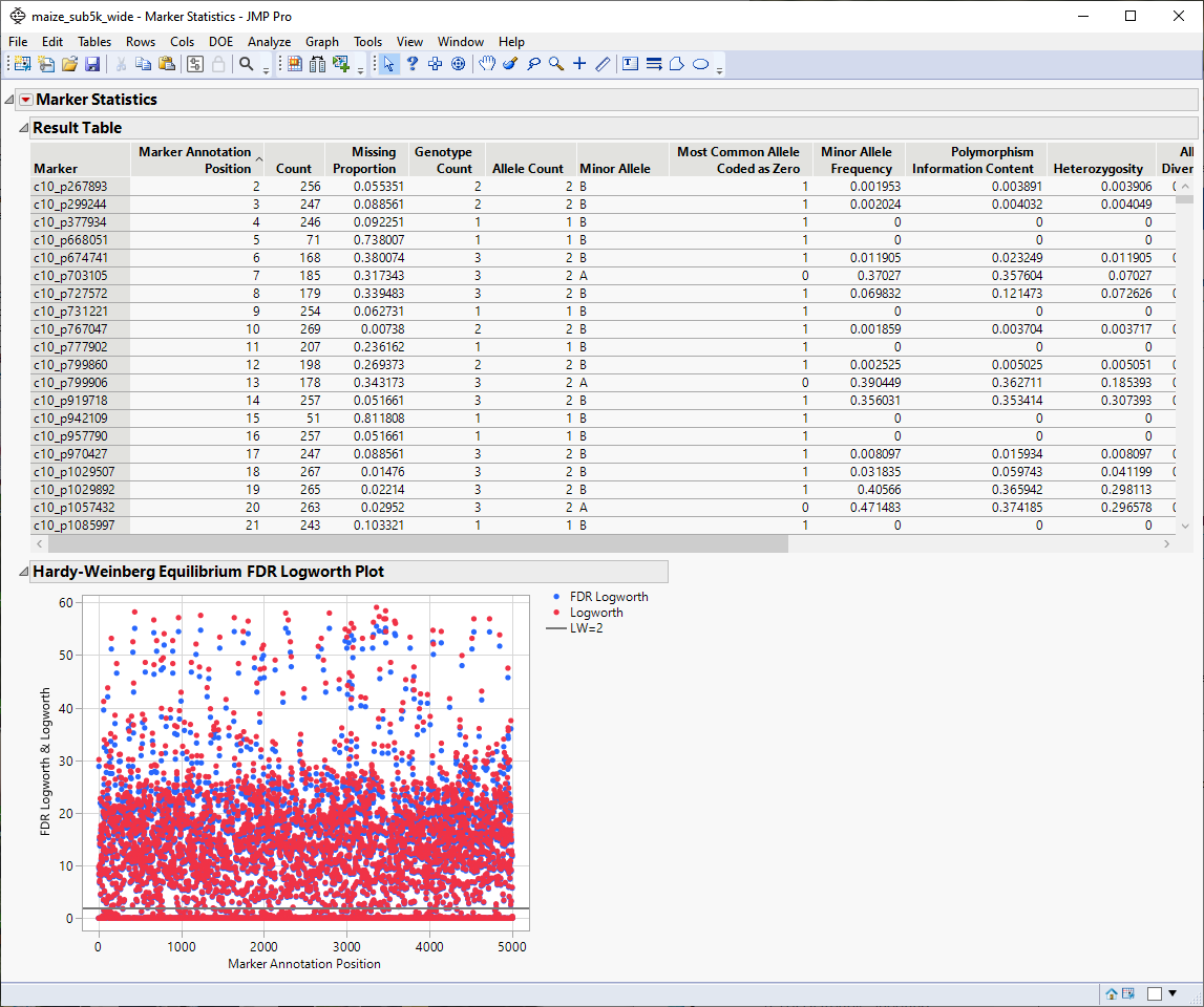

| 1 | Run Marker Statistics (Analyze > Genetics > Marker Statistics ) platform for all markers to obtain the Report window that contains the Results Table. |

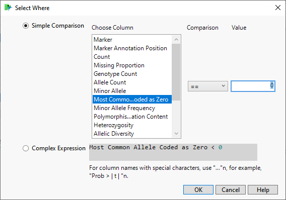

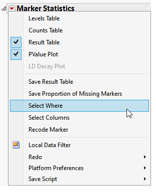

| 2 | In the Report Results window, run Select Where (from the red triangle ( ) menu) setting up Most Common Allele Coded as Zero == 0 (shown below). With this statement, only those markers for which the most common allele is not coded as "0" are selected in the Results Table. |

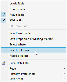

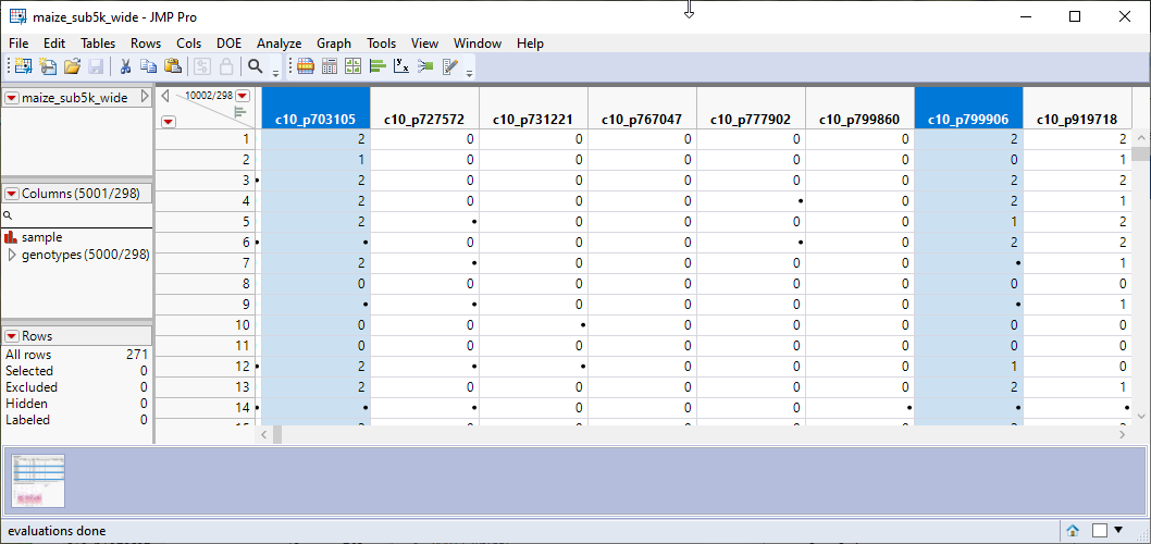

| 3 | In the Report results window, run Select Columns (in the red triangle) to select markers in the wide numeric data table that correspond to the selected rows in the Results Table. |

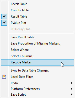

| 4 | In the Report results window, run Recode Marker (in the red triangle) to recode selected markers accordingly, that is,, 0→2, 1→1, 2→0. |

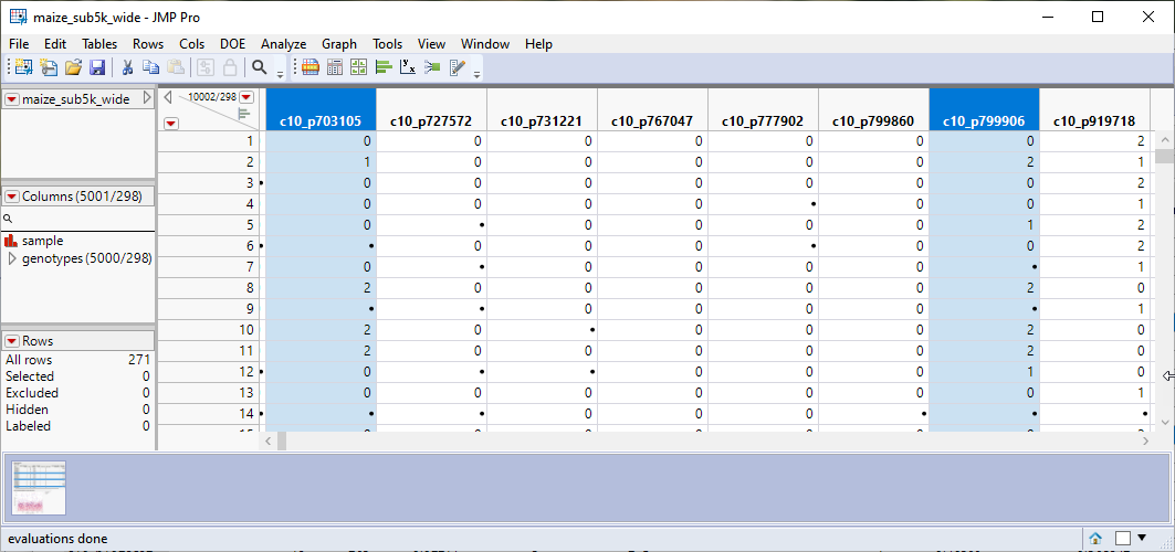

Note that the selected columns have been recoded.
