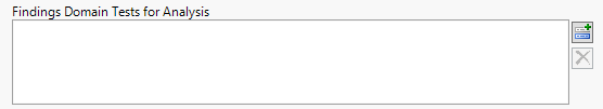

Use the text box to specify the Findings tests from the selected domain to include in the analysis.
To Specify the Findings tests:

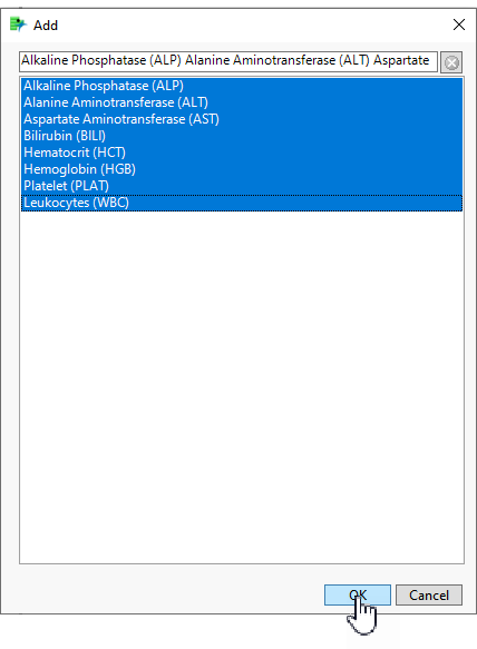

| 8 | Click to open the Add window (shown below) that lists each variable contained in ADSL or the available Findings domains and respective SUPPxx data sets (if merged). |

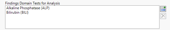

| 8 | Select the tests you want to include in the analysis and click to add those variables to the text box. |
In this example, ALP and BILI were selected and added.

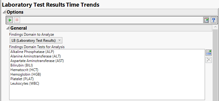

The filled text field is shown below:

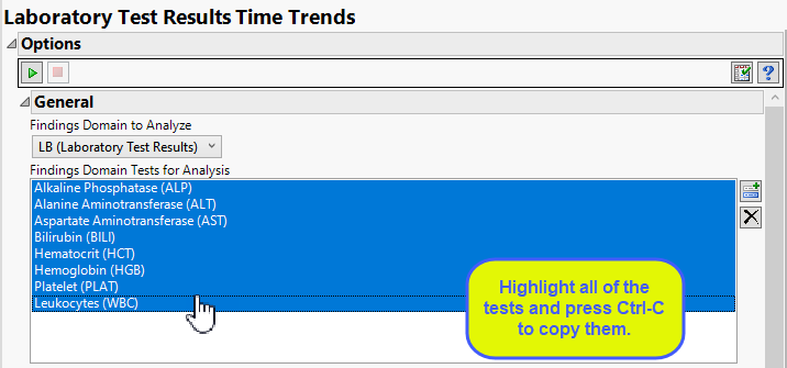

| 8 | Highlight all of the tests in the field and press Ctrl-C to copy them. |

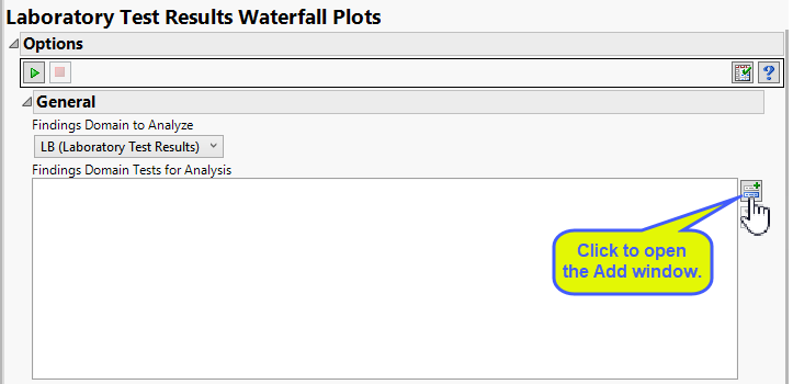

| 8 | Open the next report (in this example, we'll use Findings Waterfall Plots) and click to open the Add window. |

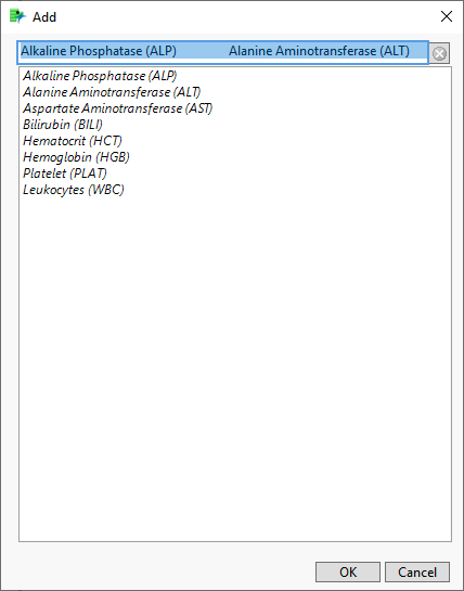

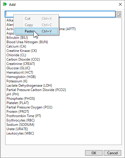

| 8 | Paste the copied tests into the text box at the top of the window. |
The Findings tests are subsetted and only the selected tests are shown in the window.
| 8 | Highlight the tests and click . |
The findings domain tests originally selected in Findings Time Trendsare now selected in Findings Waterfall Plots.
