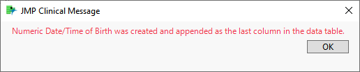

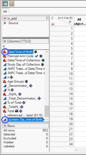

This report adds a new column (highlighted below) containing the converted date values to the end of the JMP table.
Note: The label for the new column has “Numeric” appended to the original column label.
Compare the
icon (circled, above) for the original column in the Columns pane with the
(circled above) for the new column. indicating the new variable is a numeric (continuous) variable.
