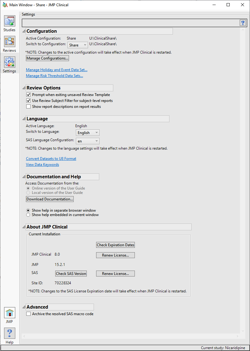

Settings
The Settings tab is used to specify general settings that apply across all JMP Clinical functions ad reports.
Configuration
Use this feature to choose where to access the study information. Local specifies the default folder on your machine’s hard drive (typically C:\Program Files\SASHome\JMPClinical\**\LifeSciences\1). Other options (such as “Shared) indicates a location on a network drive that has been set up for use by multiple users.
Use the Switch to Configuration drop-down menu to select an alternate configuration. You must the click and then reopen JMP Clinical to effect the change.
Links are provided to the Holiday and Event and the Risk Threshold data sets. Refer to Manage Holiday and Event Data Set... and Manage Risk Threshold Data Sets... for more information.

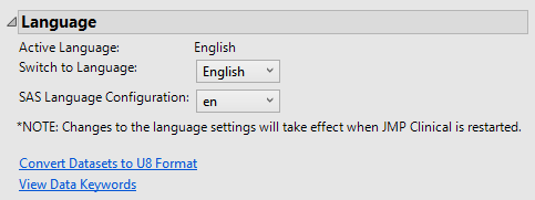

Language
JMP Clinical supports use of either both English and Chinese languages, as well as partially supporting Japanese.
| 8 | Use the drop-down menus to change language usage by JMP Clinical. |
Language options include English, Japanese, and Chinese. Allowable SAS language configurations for data include en and U8.
The following language-related options can be specified here:
| • | Convert datasets to U8 format: Use this option to convert your data sets to U8 format. This format is used for languages other than English. |
| • | View Data Keywords: Use this option to view a table of the keywords for the variables in your study. |
| 8 | You must exit and relaunch JMP Clinical in order for the language change to take effect. |
Note: If you do not see all three languages in the drop-down menu, you might need to add them to your JMP Clinical installation. Refer to How do I view JMP Clinical in a language other than English? for more information.

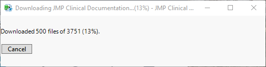

| 8 | Click to download and install the JMP Clinical User Guide to your local machine. |
The download process can take several minutes. A window opens, showing the progress of the download.
The option for selecting either the online or local versions of the documentation become active once the download has completed.

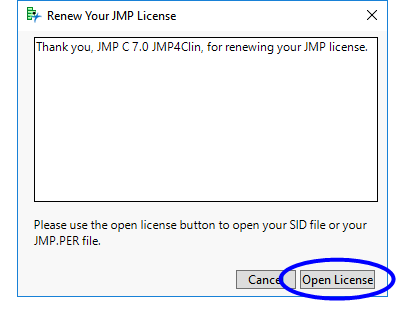

To renew your JMP Clinical license:
| 8 | Click to open the Renew Your JMP License window |
| 8 | Click to open a Finder window. |
| 8 | Navigate to your new license file. |
| 8 | Select the file and click to renew your license. |

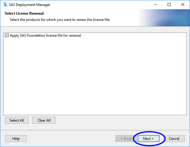

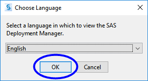

To renew your SAS license:
| 8 | Click to open the Choose Language window |
| 8 | Click to open the SAS Deployment Manager. |
| 8 | Click and follow the prompts to renew your license. |
